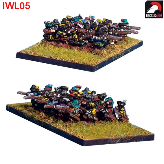

Painting Landsknechts
31st Mar 2025 03:04:01
The latest batch was done from a straight black undercoat, but I think I get the brighter colours in place.   They are definitely an easier task to paint than the pike:
