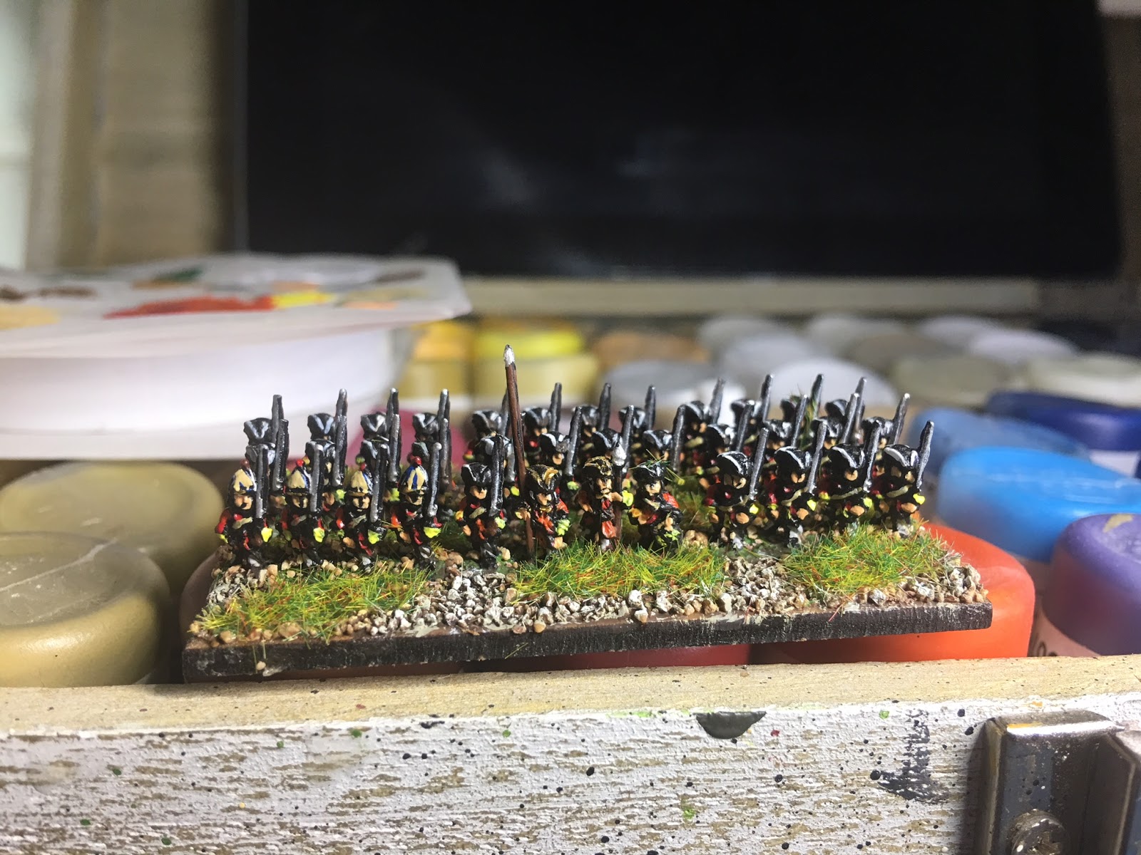

Hi, I base in 3 ranks with about 5mm between ranks. My tried and trusted method is to cover the base (60 x 30) with a fairly thick layer of good quality PVA glue first. The working from the front rank to rear set each figure strip into the glue whist adding a touch of thinner PVA to the strip bases as you place them. I then cover everything in extra fine ballast and leave to dry before turning upside down and tapping off the excess.
Next stage is to drop ink (Vallejo Umber brown in my case) onto the front and rear of the base which will run into the 5mm gaps between ranks. I use a long handled thin brush to work it around in the gaps and a steady hand to drop into any areas where the ink has not run. Again once dry a small long handled brush will just about fit down that gap to apply slightly thinned PVA to apply the static grass. I give the base a good tap to help settle the static grass.
I think ink wash is far easier to work with on these small bases, and use PVA thick enough to set the figure strips right down into it, this should help you to disguise those strips. Btw, I always file my srtips a little before I undercoat  them as part of my prep. I also give the exposed areas of stone a slightl drybrush of off white, just personal taste.

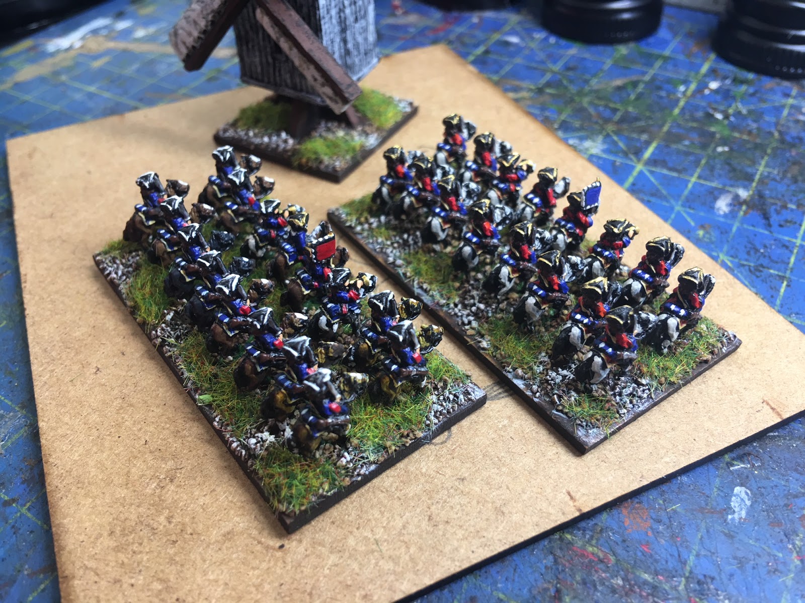

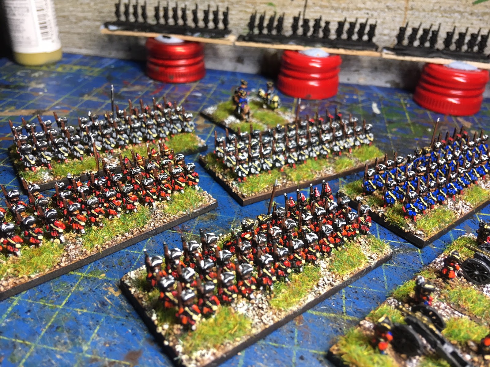

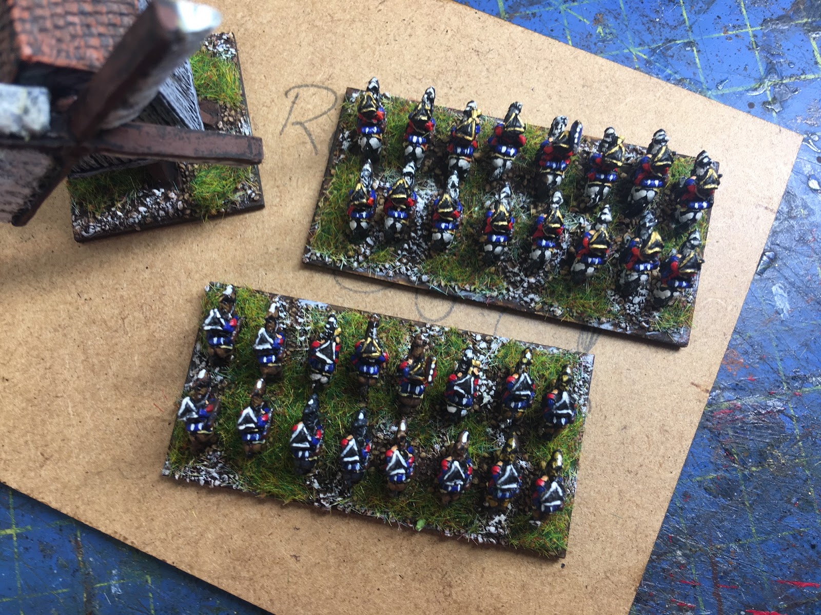

The above is what I currently use, £2.78 via Ebay and I think it's the same grade used in the Baccus basing kit? The old (now retired) Barbie box was the same ballast plus a bag of brown flock. I just use the ballast now days. The key is to quickly set all the figures strips into the glue giving each strip a touch more glue between figures etc. A cocktail stick can be sued to reposition to taste before covering everything in the ballast and leaving it all to dry.
It's a very quick and easy method. Did these two WSS units over the weekend (Lord Hay's Regiment rode greys). I use the same for basing my buildings (Battlescale 6mm).

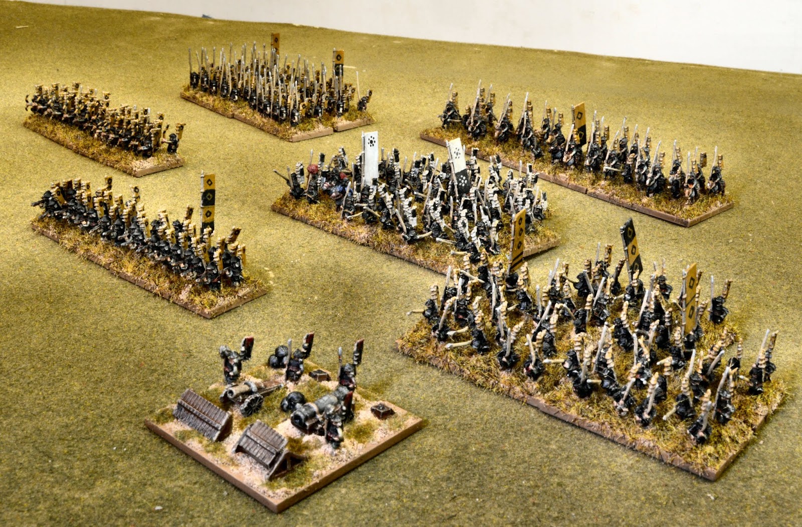

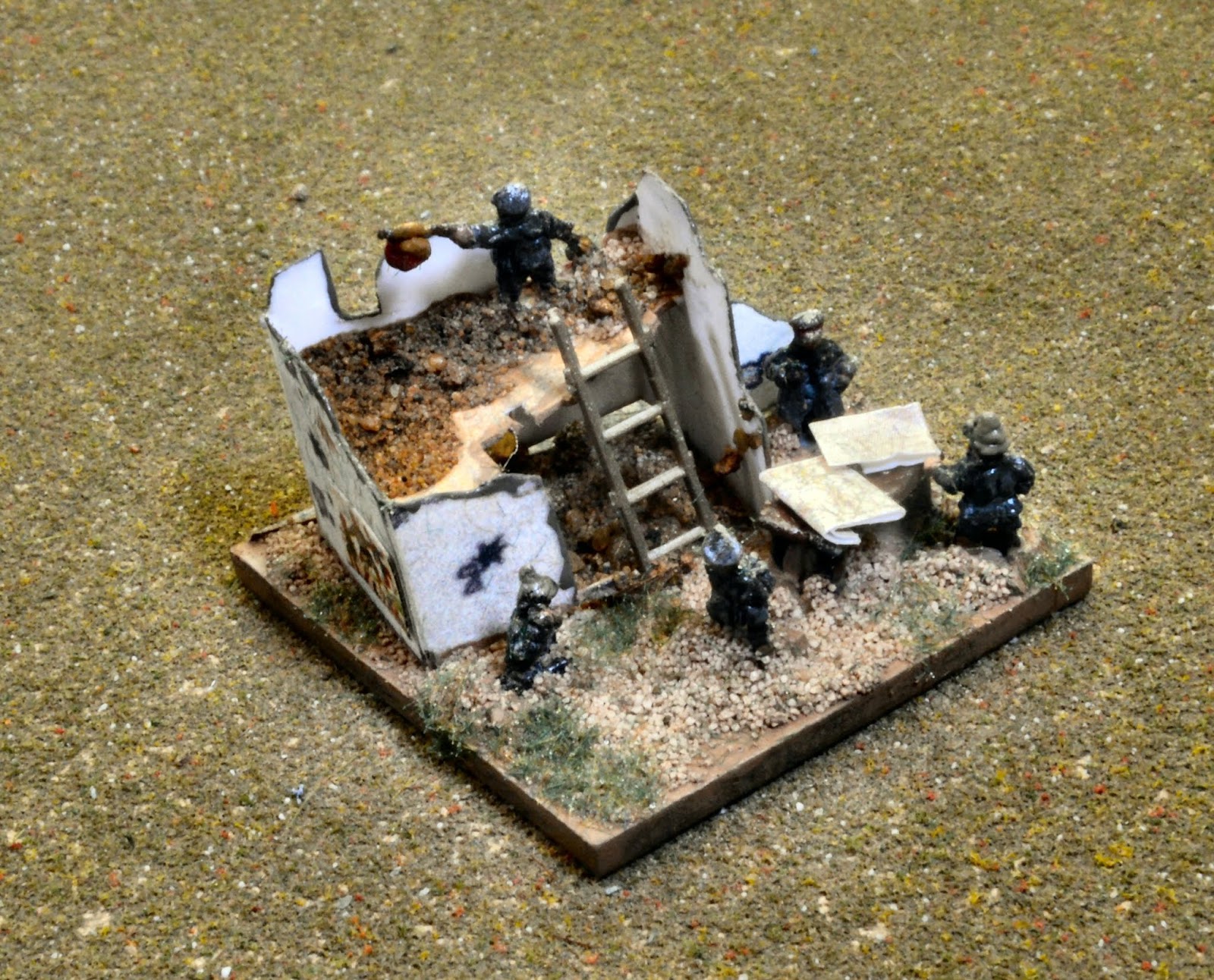

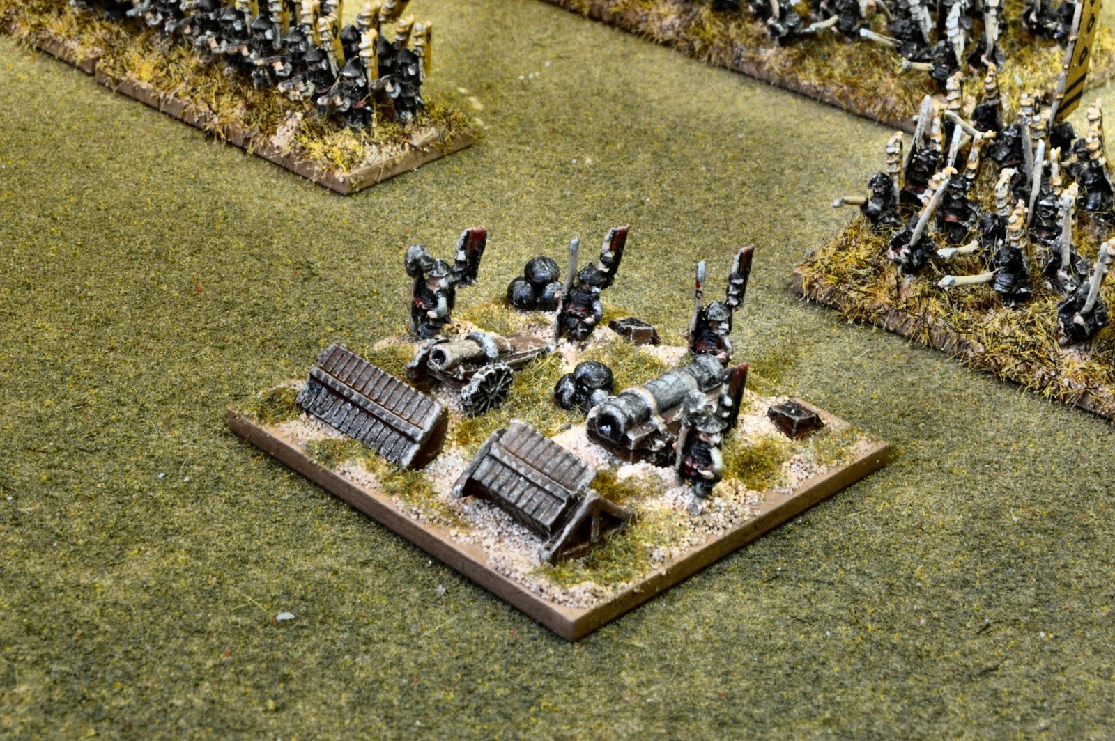

I make my own basing mixture. Mix up paint, water, sand and pva into gloop that is the right consistency then apply with a worn out brush. Sprinkle on your favourite flock to taste, either whilst it is drying or, after it has dried,  just add a few blobs of PVA if you want patchy with the base material showing through.
there are a many examples on my blog and I've picked out a few random examples below.
https://pushingtinwargames.blogspot.com/
