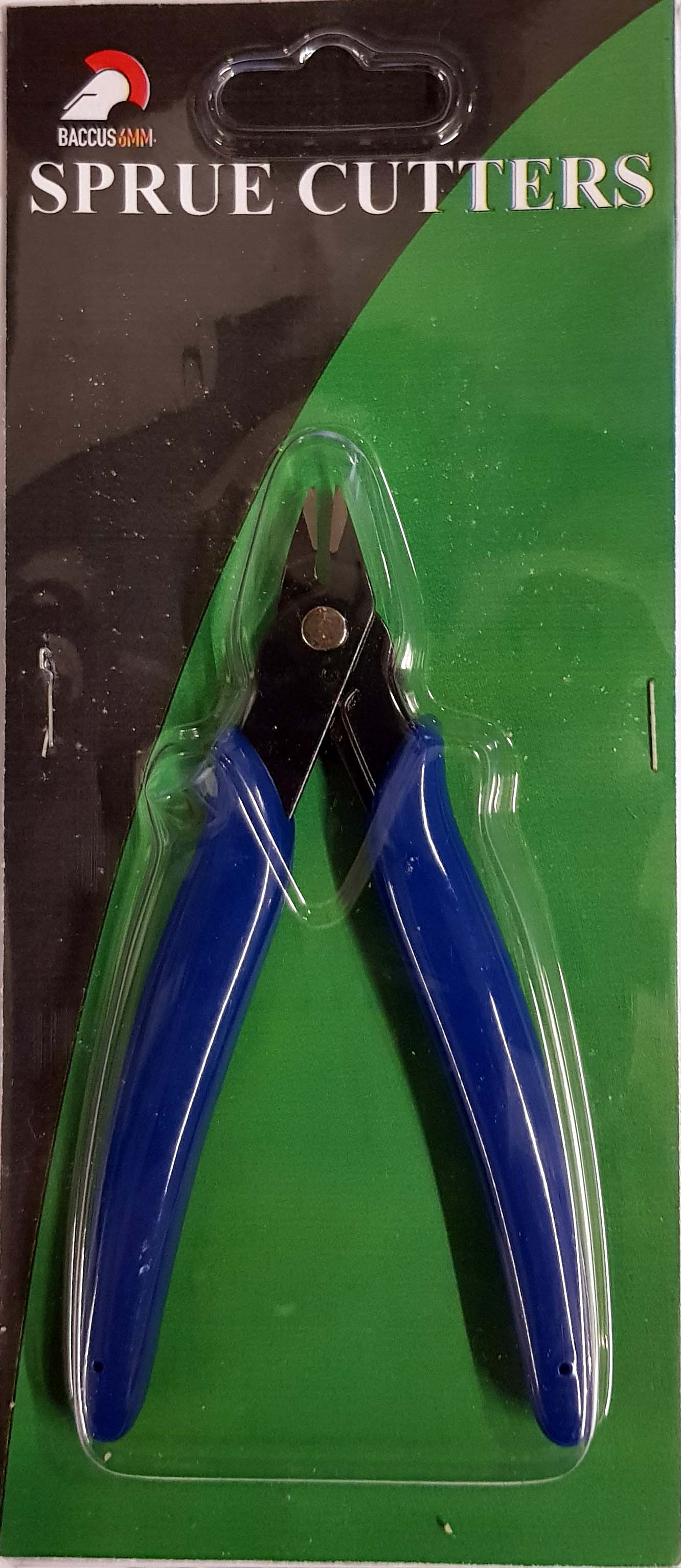

I find splitting pretty easy using the sprue cutter available from Baccus for that very purpose. I do find it easier to paint first and separate afterwards for units such as 1866 Austrians in attack column, but this is because I like bigger bases to produce a diorama effect.

I usually split, then rebase spread slightly apart on blue tac covered spills, it means I can choose which way round I want them to ease the quick paint job. Also, a spill can take up to a dozen figures at a time. After putting them in the blue tac on the spill, I spray undercoat with black, then onto painting! Good luck with whatever you choose! By the way, I split them using Baccus cutters.
